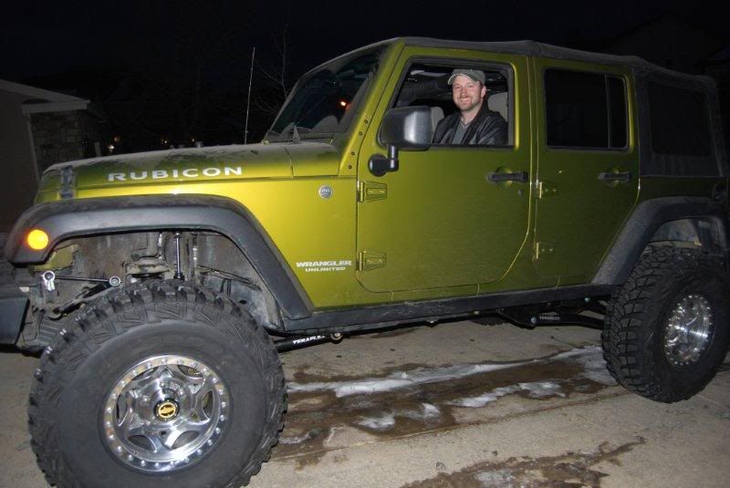

Ok, I have some pictures of the tires!!!  Sooo, sweet!

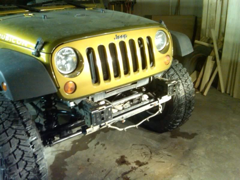

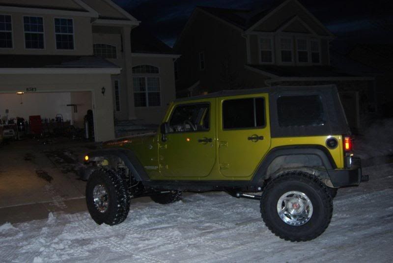

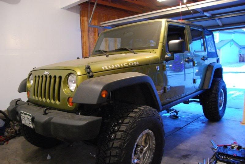

Here are a couple of pictures of the jeep in the garage with the axles and tires installed...
I need to get the rear trac bar installed (waiting on delivery) and install the shocks and driveshafts (have rear)...
Enough takling, here are the pictures:

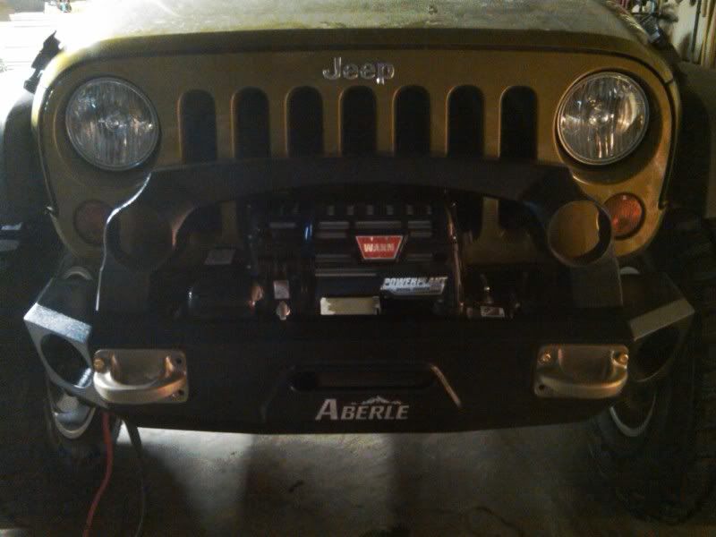

Looks like time to mod that front bumper lol. Looks sharp man !

Well, I have offically driven the JK out of the garage and it actually fit!!!  I think there was about 1/2" between the highest point on the JK and the top of the garage.
There are a few things I need to do again, for starters my brakes are nearly non-existent so I will bleed those again in the morning.
I only drove around my block due to only have 2wd (don't have front shaft yet) and having next to no brakes on ice is not fun  :lol:
Well, enough talk, here are the pictures!!
I must admit, the last picture is now my desktop background!
MAN it feels good to have it rolling under its own power again.  I think there is something screwy with the ABS stuff as the light kept coming on and I didn't see the speedo move (although I didn't go very fast AT ALL).  I think that may be because of the steering wheel not completely centered?

Well, I spend about 3 - 3.5 hours at Aberle's shop today with my jeep and powerplant winch.  They are an AWESOME bunch of folks and have a fantastic product.  They made a few small updates to the bumper design and are working on the "new" generation of bumpers and I will be the first to own it!!!!  They went ahead and lent me the current bumper to drive on for a week while they get the new design cast and painted/powedercoated....
I have sevearl pictures on my phone, i need to get them off my phone and onto my computer so I can post them up for everyone to see.  I will tell you this front bumper has me very impressed!
Their new rear bumper is truely a GREAT design as you only have to open the tailgate to get the whole thing opened.  You don't have to undo a tire carrier and then open the tailgate.  It is the highest clearance bumper I have seen to date.  It also has the pin for the tire carier cast into the bumper instead of welded on so it is VERY strong!!  I even got to watch them pour the metal into the castings for the bumper (VERY cool if you have never seen liquid metal at 1400 degrees).
I also drove over to Front Range Driveline and my front driveshaft was made today.  Those guys seem to be really stand up guys as well...
The Jeep drives like a dream on the interstate.  I do need to balance the tires at about 70 - 75 MPH it has a slight bounce in the tires but it is barely noticable.  With the 5.38 gears the JK actually accellorated up C470 west towards I70 up the incline in 6th gear!  Stock on 32's and 4.10 gears I had to down shift to 5th to hold speed....Although at 70MPH I am turing 3K RPM now so the motor is wound up a little tighter.
So does anyone know where I can get a synthetic winch line cheap??
*Edit:  Here are my cell phone pictures of the "mock up"
I know they took tons of pictures are are planning to post them up on JKOwners tonight.

That is a sharp bumper. Keep the pics coming.

Good looking bumber!! Is it one piece cast from aluminum?  Execept for the bolt on tow loops.
Yes, it is a single cast peice with the exception of the hoop (that is bolted in).
One of the guys/owners actually hooked up a forklift to a strap attached to the hoop and lifted the entire jeep off the ground by the hoop!!  He showed me a video of him ramming a bolder at 10-15 MPH and it did nothing to the bumper.  The video then showed him hitting a ~6" diameter tree at 20+ MPH and then backed off and there was NO damage...I was impressed to say the least.  Coolest part is the bumer only weighs about 65lbs!!
